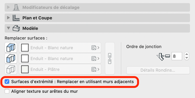

Rico
You need to select this option:
I don't remember what it is in english but it should be self-explanatory.
Rico 

Perfect! That solved it, never seen that option before. Thanks!
