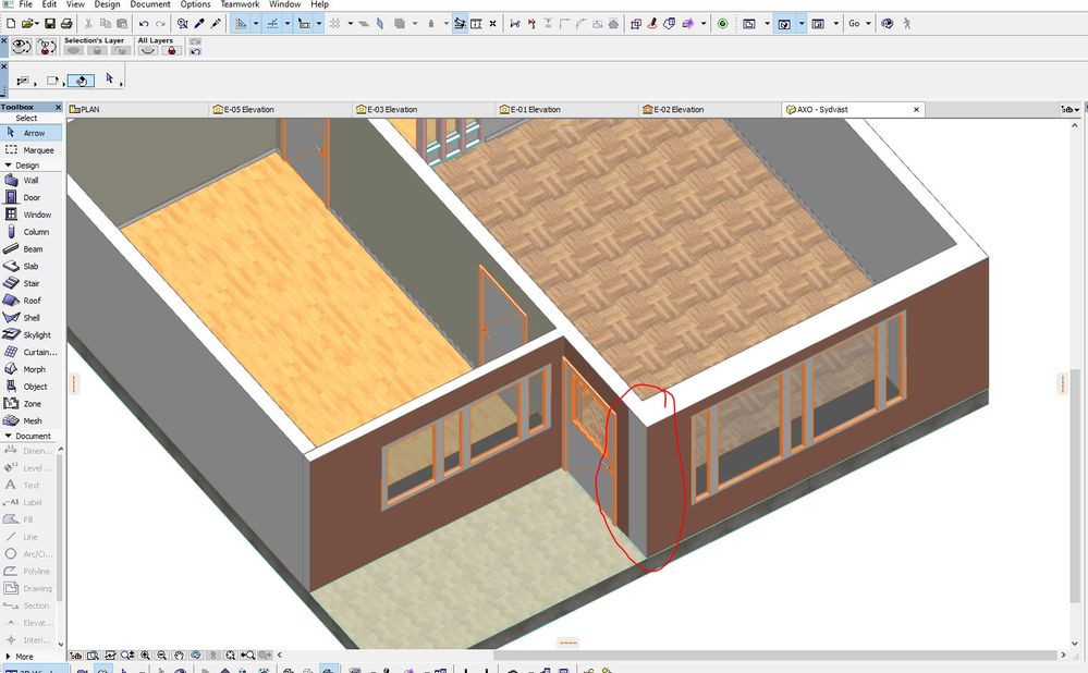

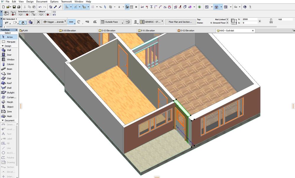

Edge material prioritized over outside surface material
DangCad

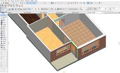

In my model, there is one corner where the edge surface material is visible instead, and I can't figure out why. See screenshots below, two where the walls selected if it helps.

Screenshot 1 - Archicad.JPGScreenshot 2 - Archicad.JPGScreenshot 3 - Archicad.JPG

Rico
You need to select this option:
I don't remember what it is in english but it should be self-explanatory.

Perfect! That solved it, never seen that option before. Thanks!
