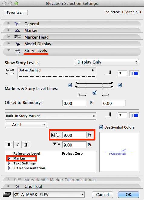

Is there a way to edit the text size or position of story level text?
1 Reply 1
NCornia
Graphisoft Alumni
Graphisoft Alumni
Muckster,
In the Navigator right-click on the Section/Elevation/Interior Elevation (will be referred to simply as Section from here on out) and select its Settings. In the Section Settings Dialog box you can change the text size and some display options of the story level lines. There are a number of placement options under the Marker parameter. For instance if you wish to offset the marker up or down from the actual story line you can adjust the length of the First and Second Line Parts and then adjust the Second Line Part Angle. After you make these changes click on the Favorites button at the top of the settings window and save as a favorite. You can then go to your other Sections and apply this favorite. For all new Sections double click on the tool in the toolbar to open the Default settings and apply the favorite there. Now new Sections will have the settings applied.
