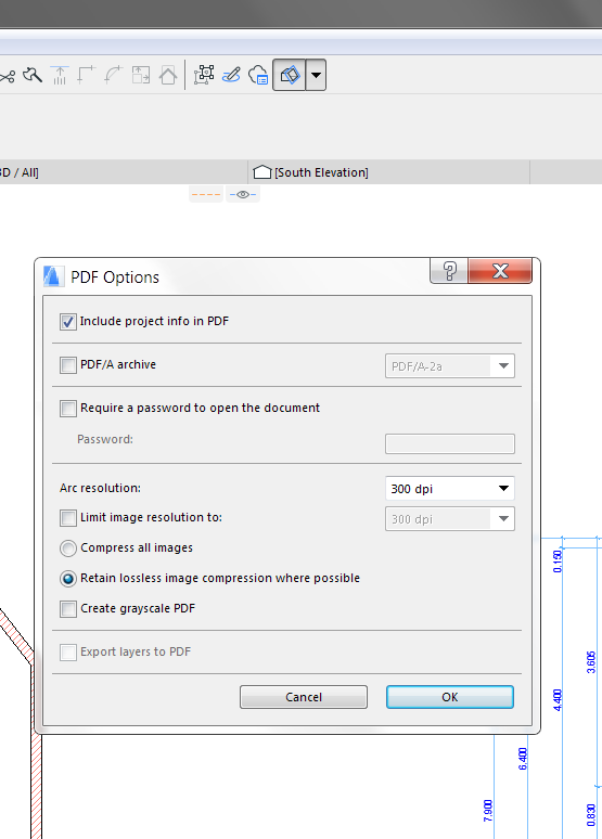

The problem is that there's no "embed 3d content" checkbox as it mentions on step 6 (I've attached a picture of how the options appears for me).

I haven't used this in years - and even then I never did seriously.
The embed 3D content is there in version 15 but not in version 18 (haven't checked 16 or 17) so it looks like a feature that may have been discontinued.
Although the save as U3D is still there in all versions.

Yes, I think this U3D format was Adobe's attempt at trying to a create 3D model format they hoped everyone would use. But I never really saw its use take off. I remember I tried it once or twice when this feature first appeared in ARCHICAD but I never found it too useful having a 3D Model embedded in a PDF file.
I don't know, having a PDF file with text and pictures is OK, but also having videos and 3D models in a PDF didn't feel that good of an idea. A dedicated 3D viewing environment seems like a better choice.
