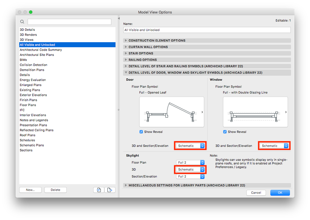

Note: Most commercially available 3D printers struggle when trying to replicate fine detail. Models that are simpler geometrically tend to yield better results. Simplification is recommended but optional.
3. Go to Document > Model View > Model View Options...
4. Under the Detail Level of Door, Window and Skylight Symbols tab, change the 3D detail levels for doors, windows and skylights to Schematic. Click OK.
Note: This further simplifies the geometry of the model and is recommended but optional.
5. Save a view of the model to avoid doing this again during a future export.

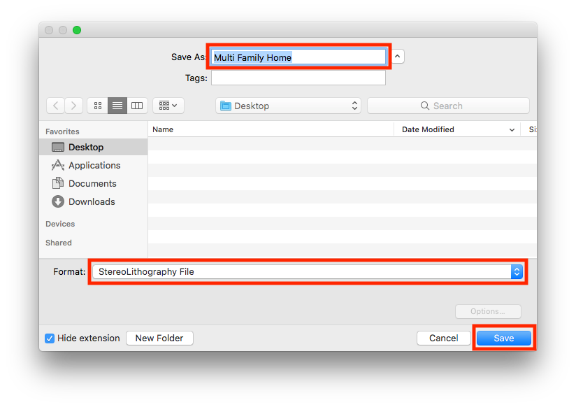

1. From the previously saved 3D view go to File > Save As...
2. In the save dialogue box set the format to StereoLithography File, name the file and click Save.
3. In the Save 3D as STL change or verify the settings and click Save.
