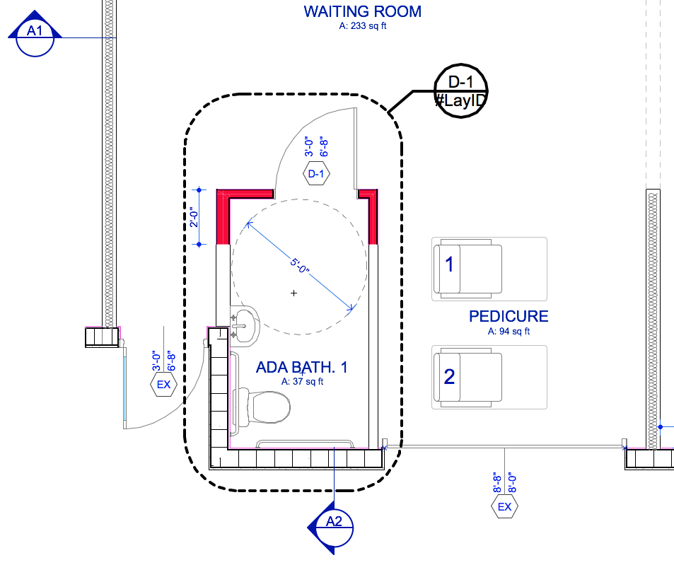

HI THERE... I am making a floor plan detail to show the ADA bathroom in a larger scale.
I placed a DETAIL MARK in the floor plan to refer this floor plan detail but the detail is an EXPLODED drawing (just lines/hatches & texts). Is there a way to keep de detail as MODEL?
I'd like to be able to place the INTERIOR ELEVATION MARK in this floor plan detail but it will only work if i am working in a 3D model.

You can create another veiw and place it on the Layout at a different scale.
Enlarged plan view has been on the wish list since the detail tool was introduced. Actually on my wish list for longer than that. I first started working around this limitation back in 1996 with masks and layer combinations for plan details.
For details the present situation seems OK since it's generally inadvisable to edit the model in a detail view, but a live enlarged plan view sure would be nice.
I went around by saving a floor plan view in 1/2" scale and naming it ADA RESTROOM PLAN DETAIL and then referenced the DETAIL MARK in my 1/4" scale floor plan to the drawing now inserted in the Lay Out Book.
Once that was done I removed the "INTERIOR ELEVATIONS MARK LAYER" from my Floor Plan layer combination and aded it just to custom 1/2" view.
A little confusing but well.. it's working...
