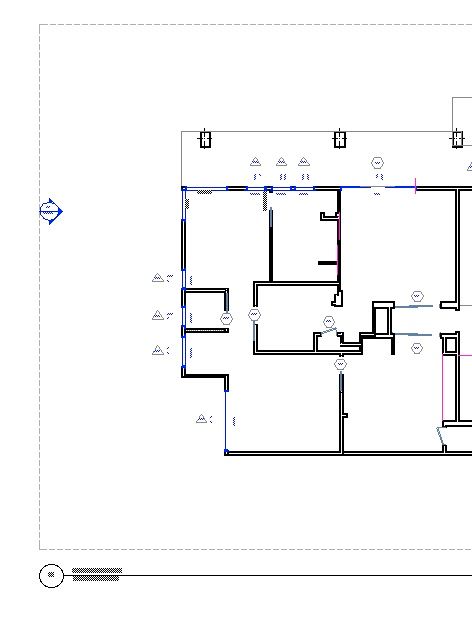

I think it must be a layer issue but I checked and the A-FURN layer is on, how come the fixtures don't show up in the layout. How do I control what shows up in the layout view window?

It's all controlled through the View Map. Is that where you are checking the layers? The layers you currently see in the floor plan window are not related to what it in the Layout.
