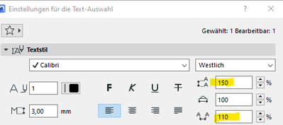

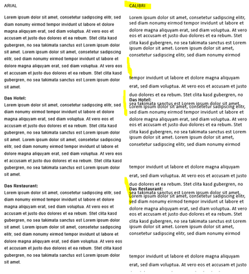

Hello, does anyone know if this is an aknowledged bug?
We observe a number of fonts misplacing in Archicad 26 upon changing relevant character and line distances:

There was an issue with fonts I recall with early builds of Archicad 26. Have you installed all of the latest updates and hot fixes?

Yes! Thank you! We didn't have the latest build!
The bug is gone
