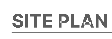

Hello,
Our company uses "Inter" font using the .ttf files installed on our computer. It seems ArchiCAD has a hard time with it. Whether I do a "save as" or a "publish" the font doesn't show correctly. It seems the issue is always the center of the font where horizontal, and verticals meet. See attachment as an example. My research shows that ArchiCAD should be able to use this font type so maybe there's a setting or something i don't know about. Looking for help.
Thanks.

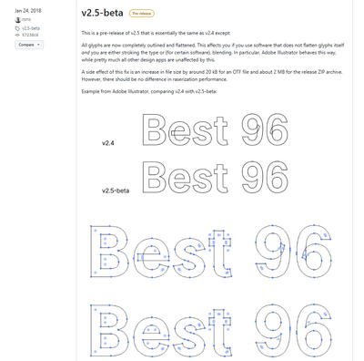

I wonder if you are using an older version of Inter. I looked back through the earlier releases on the GitHub page for Inter is saw that back in 2018 between version 2.4 and 2.5 they "flattened" the glyphs.

interesting! I bet that's it. I wonder how i know what version i have.
I had high hopes and jumped the gun. I had v3.0 installed and tried installing v4.0 but still have the same issue, infact it's worse with the later updates and turns to symbols.
