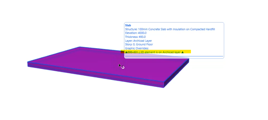

Archicad 27 on a MAC platform. For some reason, all my beams are solid pink. I tried looking at all the graphic 0verrides, and all the different settings don't help.

Hi Mukster,
I can think of two other possible issues:
  1. Some building material / composite / surface / texture is missing
  2. If the beam is actually a wall or column element it's height could be inverted. (See: https://community.graphisoft.com/t5/Modeling/Pink-Walls/td-p/163922)

mukster
It was the Work Environment/On Screen options
Josh Verran
When you hover over an element, if a Graphic Override is affecting it, it should show up as highlighted below.
That might help isolate the rule.
As mentioned above, if there's no rule affecting the element, it could be missing attribute, although this normally shows as black and pink checkers.
