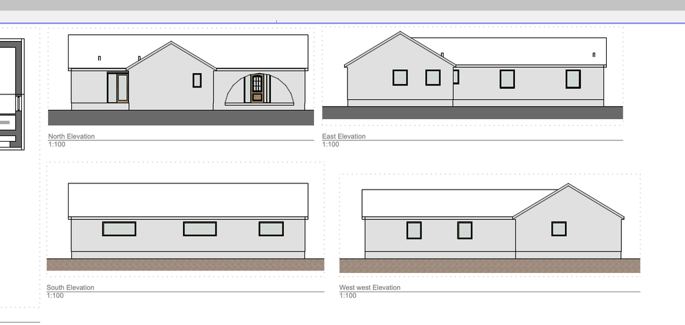

I'm having an issue with my GO. I've 4 elevations, all with exactly the same MVO, GO and elevation settings, however two are appearing different. The top two are correct, the bottom two seem to want to show the mesh differently. Am, I missing something obvious?

It could be that two of the elevation markers are cutting the mesh and the other two are not.

thanks, thats exactly what it was. duh!
