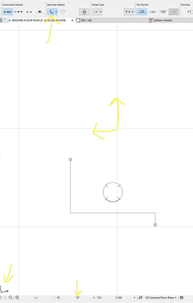

Hello,
I have a rotated view in which I'd like to place some dimensions. I want them to be in standard rotation, as in, dimension line are perfectly horizontal and vertical. which is something Archicad does by default. nomatter the rotation of the view, standard dimensions are always standard.

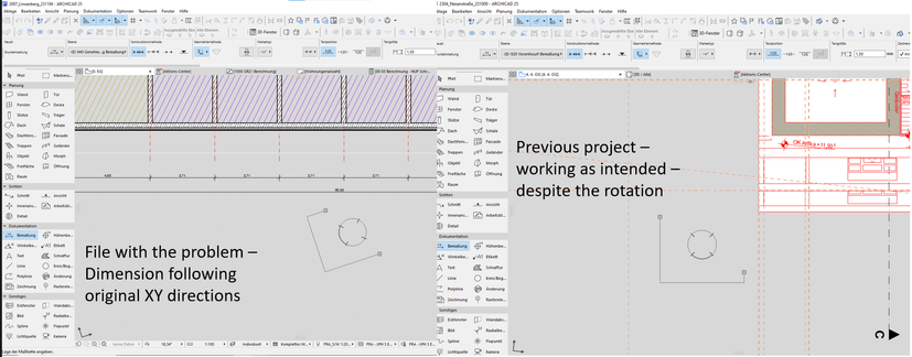

However, suddenly this is no longer the case. I'm very sure I didn't change any of the settings and I've been wokring on this project for weeks. But one day I started Archicad in the morning, and it wasn't working like that anymore. My colleague and I checked all the settings together, and nothing. I don't think there a setting for this to begin with. I attached an image and compared with another project.
Thanks in advance.
