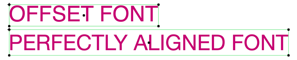

Hi All
I have encountered a Font issue that is not specific to Archicad version or platform. I have a commercial Font (Helvetica) that displays offset from its centre. It means that when called into an object (such as a Label or Marker etc), it never displays in the position intended. See attached image: 'OFFSET FONT' is the offending font - notice it sits higher in its bounding box. 'PERFECTLY ALIGNED FONT' is how most other fonts locate within its bounding box. It has nothing to do with the Text Style setting 'Leading' as this is set to 100%.
I have tested this in multiple Archicad versions (22,23,24,25) and on both Windows 10 and Mac OS 10 and 11. Has anyone else experienced this? Does anyone know of a fix? It is driving me around the bend!

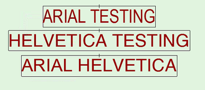

I am on Windows but am not seeing this.
What happens if you mix Arial (or another font) and Helvetica all in the same piece of text.

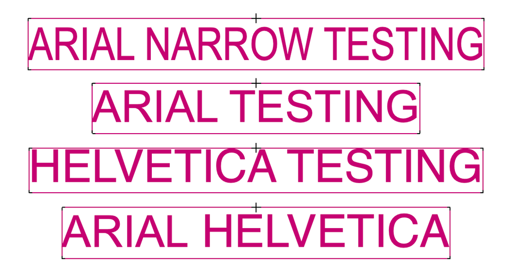

See attached. Adding another font to the textbox does appear to 'recentre' it. It is bizarre. This is actually a client (on Windows) who I developed a template for who is using this Font. We have had nothing but trouble. I am wondering if it started with me developing a template on Mac with this font and passed the issue on. I might try a New & Reset All on Windows and start with this font outside the template and see. Cheers

That is strange.
Is it the same if you go Helvetica/Arial in the same text?

It gets even more interesting.
When I look at the properties for my Arial font, it is an Open Type font.
So I am guessing it can't be a problem with all open type fonts.
I just checked through some more OT fonts - some are OK and some are shifted.
Calibri for example is shifted up.
Must be to do with how the font was created and Archicad just doesn't handle it well.

Looking at your images, your text alignment looks fine... What is different is your Space Above. Hence why it looks normal when with another font. Without the other font on the same line, it is shrinking your bounding box. If you multiline, does the Space Above have an impact or does it use Line Spacing

Yes, the space above is impacted. Multiline doesn't change anything. Line Spacing occurs, but the Text still offsets up
