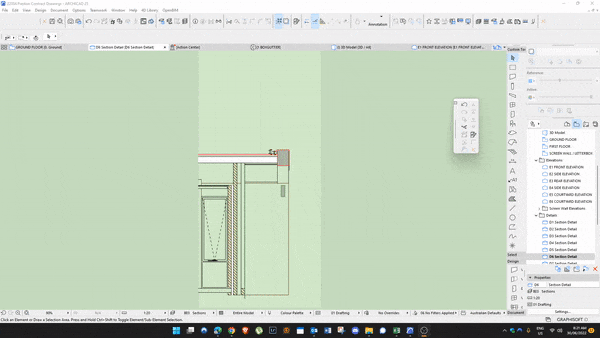

Where is the setting that allows the Horizontal Boundary to be adjustable in the Section View?
For some reason they've worked fine until now.
Thanks

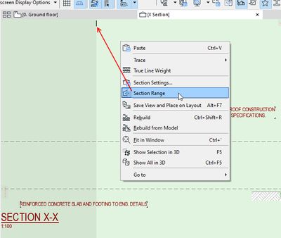

Right mouse click in the section.
DGSketcher
Legend
@Too Long Just to cover all bases, if you mean the height range of the section then you can turn on stretchy vertical limits in the section settings. By default sections are full height, but if you wanted to trim the view down for live details then these vertical height limits can be adjusted.
Thanks Barry but this is what Im referring to. Works fine in Template but its stopped working in a Project file.
AC26 AUS Full
So you can see the range, just can't adjust it.
Have you tried turning it off/on?
Is it the same for all sections and elevations in that file?
Thats the strange thing.
I can adjust it in elevation but not in section.
AC26 AUS Full
Can you drag the markers in plan?
That will change the width and maybe will reset something?
If you create a new section?
Check section settings (marker type, marker reference to, status of section view) - anything unusual there? - although that should not make any difference.
Ive actually tried all of that.
Even the new section does this.
Im at a total loss
