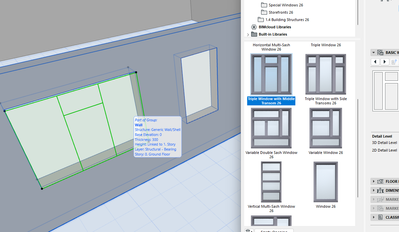

How can I remove windows, etc. from the 3D view, leaving only the structure?
AC27 on window 11

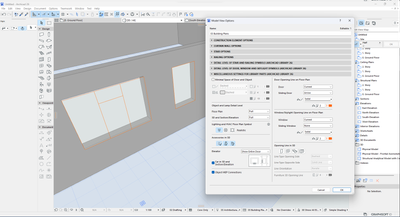

Use the Partial Structure Display option? Or create a MVO for it.
LeeJaeYoung
Set Partial Structure Display to core and
Even if I set mvo to the maximum, the window does not disappear.
AC27 on window 11
Lingwisyer
Guru

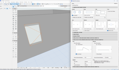

That appears to be the Opening Line, which can be toggled off under the MVO Miscellaneous Settings.

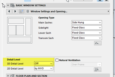

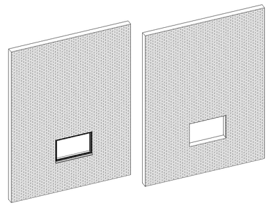

In the MVO settings, 'construction elements' only affects the plan view.
'Detail level' affect the 3D but even with 'Schematic' you will see lines representing the shape/configuration of the window.
In the actual window settings there is an option to turn the 3D off entirely.
But because it is an object setting, you can't control it with view settings, i.e. have the window show for one view but be off in another view.
