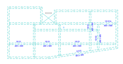

Is there a way to take the label with me even if I relink home story?
LeeJaeYoung
When I relink home story, all labels disappeared.
Do I need to redo the label?
Or is there another way?

Have you tried selecting the labels along with your beams before you re-link?
LeeJaeYoung
If you select them together, the relink... command doesn't appear?
AC27 on window 11
It was just a guess on my part, I hadn't tried it.
It does appear if you select the label first and then the beam.
Still won't work though, as it seems a label doesn't have a storey setting - the same for text.
Select both and use cut & paste.
But the height will stay relative to the storey rather than staying where it is and just changing storey.
So if you need the beam in the same 3D position, but on another storey - use re-link.
Then cut & past the labels to the new storey and re-associate the label to the beam.
Or re-do the label on the new storey and delete the old label on the original storey.
The label is not deleted, but it is not moved.
First, copy it to the destination plane and then adjust it.
