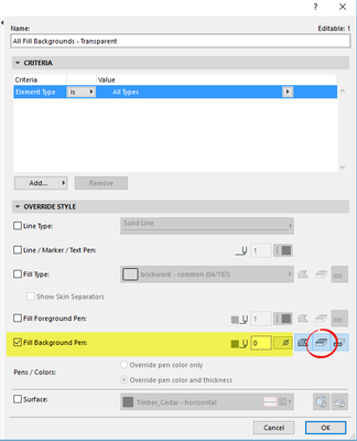

You need to apply a Graphic Override that sets the background pen for cover fills to transparent.

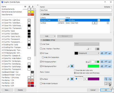

I need to remove the transparency.
There is no change. ㅠㅠ

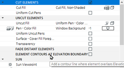

All you need is this.
You just need the cover fill active, but I have all 3 fills active.
2022-06-07 11:12 AM
There was a change, but the frame behind it seems to be due to transparency.
