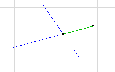

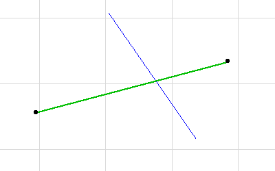

In this example, we wish to cut the near-horizontal Line with the other Line. To do this, 1. Select the near-Horizontal Line
2. Switch to the Line Tool (if you switch by ALT-clicking the Line it will also make the clicked Line’s settings the default settings of the Line Tool).

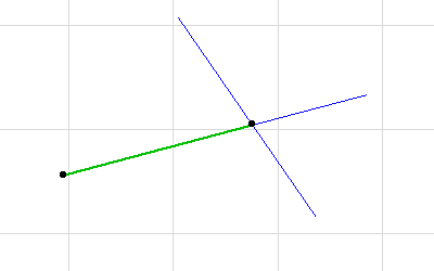

3. Place your cursor over the other Line with which you wish to split and press CTRL-click (Windows) / CMD-click (MacOS).
wp-content_uploads_2016_06_Info_18x18.png NOTES:
- The reason you must switch to the Line Tool in Step 2 is because the program produces different results depending on what the active Tool is. For more information, see the Help Center article on Trim.
- The splitter edge does not have to intersect the split element for the operation to work.
- The splitter edge may be any edge of any element that is recognized as an edge by ARCHICAD.
- After the split, the shorter portion of the split element will remain selected.

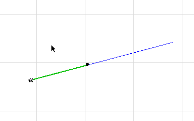

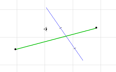

1. Select the near-Horizontal Line.
2. Select the Split command from the menu (Edit > Reshape > Split) or from the Toolbar or by pressing its shortcut key.
3.Click on the other Line.
4. The Eye cursor will appear. Click once on the side of the splitter Line where you want the split portion to remain selected.

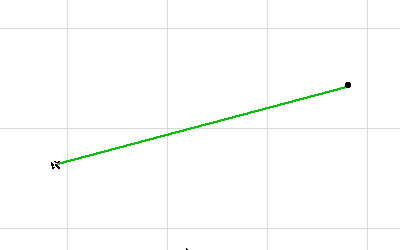

Let us say that we want to split a selected Line at 2/5th of the distance from its left end.

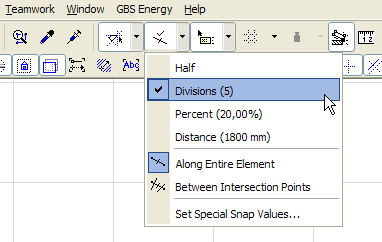

1. Click on the Special Snap Points button in the Standard Toolbar, and select the Divisions menu item.
2. Click on this button again, and this time click on the Set Special Snap Values… menu item.
3. In the upcoming Dialog, enter 5 in the Divisions field, and click the OK button to exit the Dialog.
For more details, see Special Snap Points.

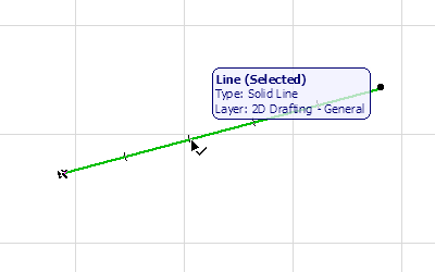

4. Select the Line to be split.
5. Activate the Split command.

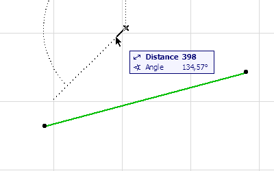

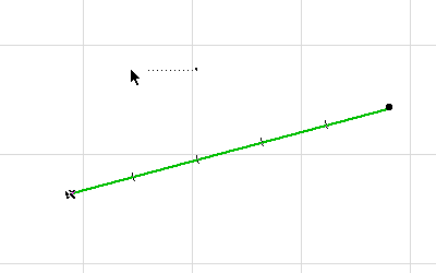

6. Now, hover your cursor over the Line you wish to split. Four Special Snap Points will appear.
7. Move your cursor close to the second Special Snap Point from the left end of the Line, until your cursor changes to indicate that it has found the point.
8. Press the ALT+X key combination to lock the X coordinate. If you move around your mouse you will see that a dot showing the current position of the input is locked to a vertical line.
See Coordinate Constraints for more details.

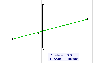

9. Click anywhere (off the Line) to specify the first point of the imaginary splitter line.
10. Press and hold down the SHIFT key to constrain the resulting Line to vertical, and click anywhere on the other side of the Line to specify the second point on the imaginary splitter line. The imaginary splitter line must intersect the selected Line for the operation to work as expected.
11. The Eye cursor appears. Click on either side of the splitter line. The selected Line will be split, and the portion on the clicked side will remain selected.

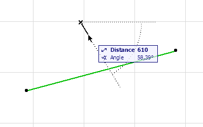

1. Select the Line to be split.
2. Activate the Split command.

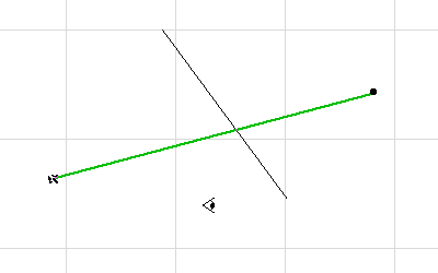

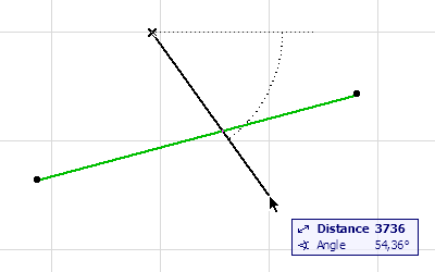

3. Click anywhere away from the Line to specify the first point of the splitter line.
4. Click anywhere on the other side of the Line to specify the second point on the imaginary splitter line. The imaginary splitter line must intersect the selected Line for the operation to work as expected.
5. The Eye cursor appears. Click on either side of the splitter line. The selected Line will be split with its portion on the clicked side remaining selected.

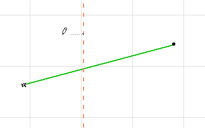

8. Press the ALT+X key combination to lock the X coordinate. This will create a vertical Guide Line that crosses selected Line at the Special Snap Point.
Move your cursor away from the selected Line and click once. Since the cursor was locked to the vertical Line defined by the Guide Line, this click is interpreted by the program meaning that you clicked the Guide Line, thereby selecting it to be the splitter line.
10. The Eye cursor appears. Click on either side of the Guide Line. The selected Line will be split with its portion on the clicked side remaining selected.
