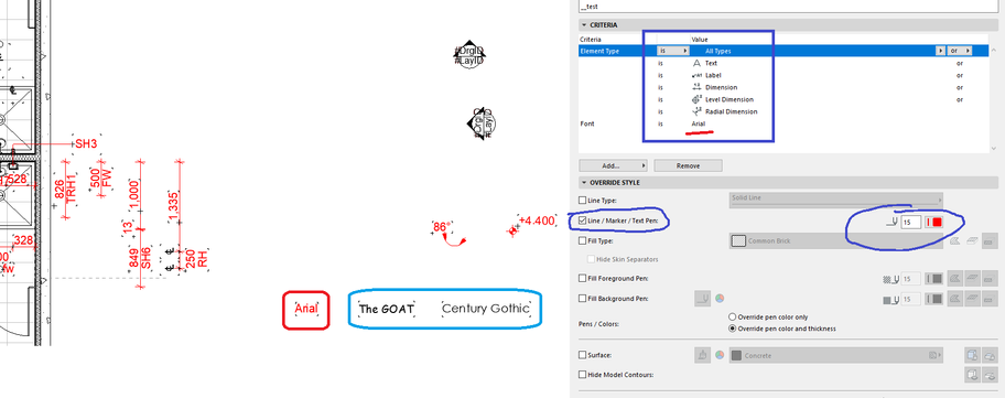

i don't think there is a quick & easy change to your favourites. you'll have to change them to suit your new standard.
although Graphic Overrides can still be useful, in the meantime. you could add a Quality Control G.O. in your current docs that highlight the old-standard font. screenshots below:

@Too Long wrote:
Or is there something like a graphic override that can do this?
Graphic overrides can't change the font, but can detect the font as Gerry explained.
