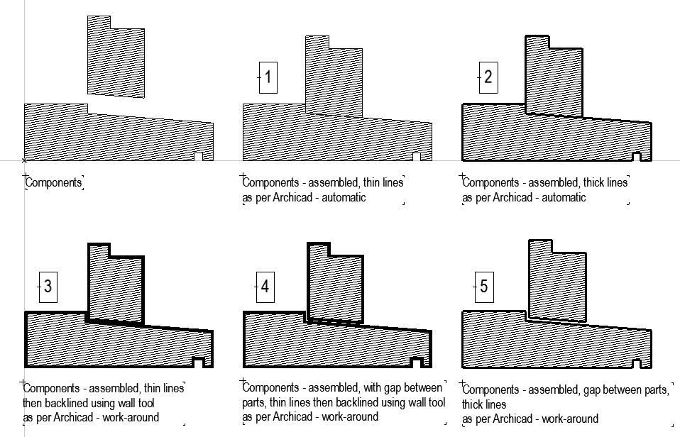

For composites you can set the pen thickness in the composite settings.
For other elements you can set the cut pen in the element settings dialogue.
However this will add thicker lines to each element - not a perimeter line around a group of elements as you seem to have done.
For that you have to manually add the lines.
If you end up adding lines I would not convert to a 2D drawings.
Just add the lines and if ever your model changes then you will see those changes in the section and you can adjust your extra lines to suit.

I felt exactly as you in about 1996 until I came across a book on Archicad by Stephen Rattenbury and Campbell Yule. They used AC version 6.0 to produce drawings as good as any manually produced plans I'd ever seen. They had thicker lines for details where important items were drawn in section, and correct relativities for other linework. Beautiful drawings - I could hang them on a wall! I bought Archicad and have been using it ever since. However, I think that the drawings in that book were produced to that standard with work-around's that you can still use. Campbell Yule (now CEO of Cadimage) might correct me if I am wrong.
I think that they worked over some linework in the details by using the wall tool to draw thicker lines inside the thin ones created by Archicad (3). This is called 'back-lining' and was a common manual drafting technique. Archicad, and other cad packages (except DataCad), can only draw thicker lines over existing thinner ones - but they can't offset them.
Rattenbury and Yule also created a space between components (4). These things can all be done but it is quite time consuming. If you are prepared to create a gap, using thicker lines for the component profile is easily done in Archicad and is probably your best cad alternative (5).
I understand that Revit allows the drawing of components with gaps - is that so? Sketchup produces drawings with intelligent line types of varying thicknesses - similar to manual drafting (but no gaps, I think).
I've attached a sketch of the options for window frames to explain what I mean.
