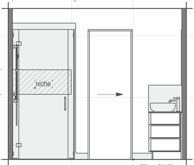

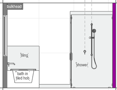

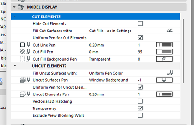

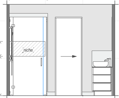

Barry, the first pic is E4 with Filled Uncut Surfaces set to - uniform pen colour, 2nd pic is E3 with Filled Uncut Surfaces set to - nothing
In E4, I can't see through the shower screen & the wall behind is coloured. It is the coloured wall on the right of E3.

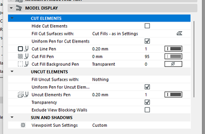

E3 is set to nothing, and I can see through the clear glass shower screen, but setting E4 to nothing (3rd picture) means the vanity bowl & tap on the right are transparent, and they allow the fill behind to show through.
I assume I need to make the coloured wall adaptable to the model display, but I don't know how. Can you think of anything?
The look of E3 is the goal without anything being seen through. If I put the vanity in that elevation, you'd be able to see through it.
Thanks for any assistance you can provide.
an hour ago - last edited an hour ago
Why do you not use "Fill Uncut Surfaces with: Own Surface Colours"? Is your glass surface set to have a transparency of more than 50%?
