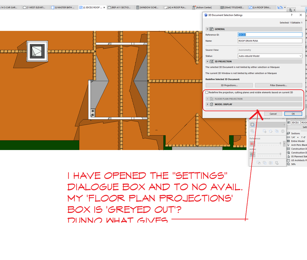

rob2218
here's the hang up. my 3D Documents "projection plan" box is not able to be clicked on?
what's happening?
What am I missing, not clicking, button not checked, box not highlighted?

@rob2218 Did you create that 3D Document View from the 3D window or the storey floor plan? The creation method is important to the results.
from the 3D window set to "plan" view from the top.
how do I create it from the story floor plan?
And.....which one will allow me to set the "view plane" height?

DGSketcher
Legend
You need to be in standard floor plan view, NOT the 3D Window. Right click and select "New 3D Document from Floor Plan...".
thanks....yup..you were correct. was in 3D window using "top" view and that causes the "Floor Plane" button to get greyed out. Great insight. thanks.
