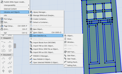

I have an isue with saving a slab as a door leaf
As you can see on the picture there's no option for me to save it as a door leaf. I don't know what to do.

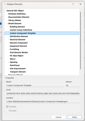

It is kind of weird it is not appearing as an option but anyway, try to select those slabs you modeled and click Save Selection as...> Object...

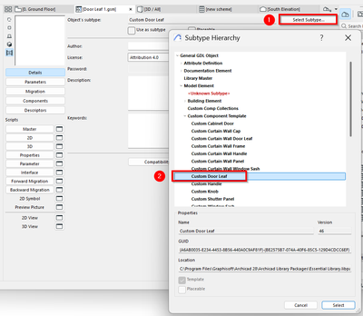

Then Open Object...> Select Subtype> Model Element> Custom Component Template> Custom Door Leaf
and Save.

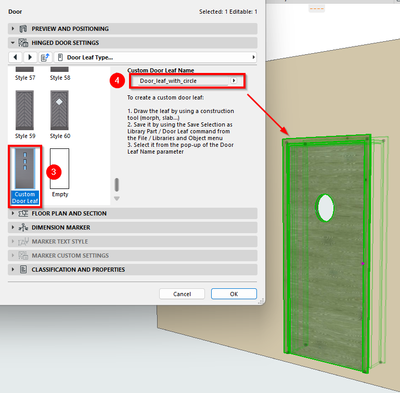

Now you can choose that custom door leaf you have just created.

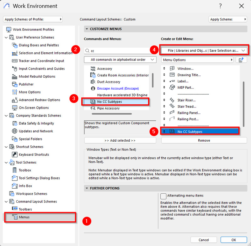

Try this:
Make available No CC Subtypes in the Work Environment as a command in the Save Selection menu to show the registered Custom Component subtypes.
