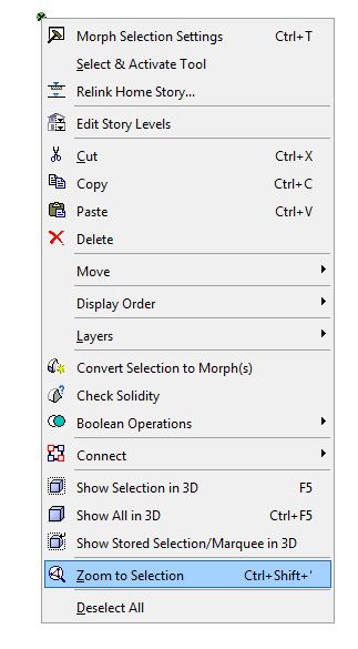

I did tried that, and it didn't work either. But this is what I found out trying to source the issue. When the 'Ignore zoom...' radio was deselected from the view settings dialog, the entire drawing became a dot on the screen. And is unable to recover after that.
I have found a way to recover the view.
With the view completely zoomed out, right click and select 'zoom to selection', then inside of View Settings dialog, select 'Ignore zoom...' and 'Fit in window' Please refer to the screen shot.
Thanks for the help!
