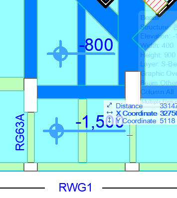

I want to do a level that sets the floor level to 0.
LeeJaeYoung
This is a structural drawing of the roof on the first basement floor.
I would like to display the level based on the roof of the first basement floor.
-1500 => 0
-800 => +700
I want to do it like this.
If you can create a new level with GDL, please let me know.

You need to use Elevation Label 25.
AC27 on window 11
You should read about Reference Levels in the Archicad Help.
You can specify a value for the 1st Reference Level or 2nd Reference Level in the Options > Project Preferences > Reference Levels Dialog. Then, when you place a Level Dimension, you can specify that the Level Dimensions displays its values relative to the 1st/2nd Reference Level, not the Project Zero.
