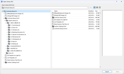

LeeJaeYoung
Built-in Story Marker cannot be opened.
Excuse me, but can you tell me your exact name? ^^

Lingwisyer
Guru
File => Libraries & Objects => Open Object by Subtype... => General GDL Object => Ducumentation Element => Drawing Symbol => Marker => Story Marker => Built-in Story Marker
I do not think "Open Object by Subtype" is on the menu be default and would need to be added manually to your workspace. It is the generic storey marker that is included with AC and used when there are no others available. How any of this translates to the Korea menu is a different question...

LeeJaeYoung
Thank you I find sotry marker gsm. ^^
Story Marker Object Location - Graphisoft Community
