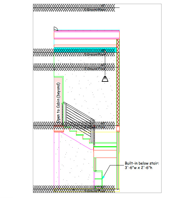

I am having trouble with the Interior Elevation tool. After some difficulty, I have the model view looking the way I would like; however, when I go to look at the same view on a layout, the Story Marker is in a different position and all of the settings are different. See the attached image.
I have never had this problem where my model view changes when I link it to a layout. Any thoughts on how to correct this?

Once you have things the way you want, have you made sure you have clicked on the "Get current window's settings" button to redefine the view's settings (in the View Map) ?
Paul Adams
Oddly, I just closed the file, opened a different one, then went back and opened my problem file and the issue was gone.
I looked at my view settings and will definitely watch for the 'Get current windows settings' button in the future.
Thanks for the tip.
