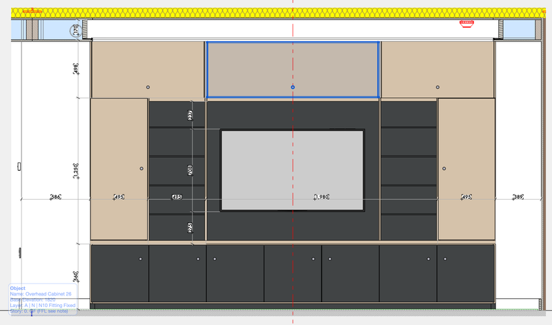

Tim Ball
Firstly I would encourage you to use the full scope of Archiocad to help you, particularly to save time in a small practice. I am sure you will also enjoy the process!
How detailed you draw things is a business decision based upon how much you need to show to get the design right and what you are being paid for. Sometimes a placeholder object will do, sometimes you can find an existing model from somewhere like 3D warehouse or a manufacturer, sometimes you just need to draw it yourself. Whatever you do, save it for future use to build up your own library.
Surfaces are a constant problem. The ones in the library are limited and generally not great for interiors. It's rare to find a tileable image from a manufacturer, but sometimes they are available. Often you just have to make your own from image files.
I have added a few files to hopefully inspire you:
  • Interior 1 - classic bathroom elevation using the interior elevation tool. Note the inclusion of autotext specification notes which is crucial to the way I work
  • Interior 2 - interior elevation of a media wall
  • Interior 3 - 3D document of the same media wall. The resolution of a 3D doc is better than using an image file and you can add notes too
  • Interior 4 - Typical layout for a bar fitting area
  • Interior 5 - photo of the finished job
