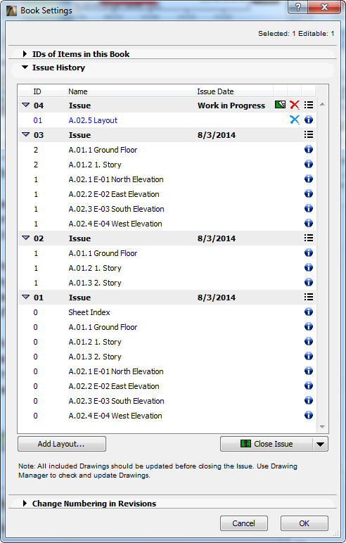

In the following image you can see how the Revision IDs of various Layout will become different:
Issue 01: all Layouts were included (I set the Revision ID for all Layouts to "0" manually here)
Issue 02: Only 3 Floor Plan Layouts were included, their Revision IDs became "1".
Issue 03: 2 Floor Plan Layouts and 4 Elevation Layouts were included. As you can see here, the Revision ID of the 2 included Floor Plan Layouts is now "2", while the Revision ID of the Elevation Layouts is only "1" as they were not part of Issue 02. So Revision ID is Layout-specific and is increased only when a Layout containing a Change is included in the given Issue.
Lastly, I also tried that "01" thing you mentioned for newly created Layouts. After closing Issue 03, I created a new Layout and then created Issue 04. When a new Issue is created, all Layouts that were non-existent at the close of the previous Issue will be automatically added to it. So this Layout is added to this Issue, but its ID is "01", and not "0" or "1" so it does not follow the formatting we have with the other Layouts. This might be a bug so I will forward this to Graphisoft. Also, I could not find a place where I could determine the default formatting for Revision IDs. They are always "01". I cannot set it to "001" or "1" or other formatting, or at least I couldn't find the place where I could.
