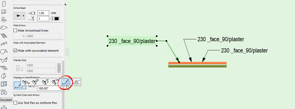

Some Archicad labels, such as Composite or Profile Name 27, have a bad behavior where the label can’t be placed to the left of the element.
Many other labels, such as Generic Label 27, can be placed properly in any quadrant.
I have several symbol labels which also have the bad behavior, so I’m trying to figure out what enables the good labels to behave.

Eduardo Rolon
By design? 😂😉

Hi @James Murray
You can find more information about Label Placement Methods >>HERE<< 👈
Sometimes it is just playing with the available settings, as we could understand behind @Eduardo Rolon's sarcasm. 😉

Thanks for replying, Ricardo. GDL question mis-filed.

Try a different marker rotation method.
