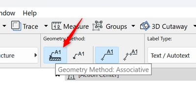

I’m having an issue with the Label Tool. I use it as an annotation tool to display information such as wall or window IDs, or elements’ top elevation to sea level. It has worked fine so far, but it suddenly stopped picking up element information.
Has anyone else experienced this issue or knows how to fix it?

Make sure the geometry method is set to Associative.

Thank you so much!
