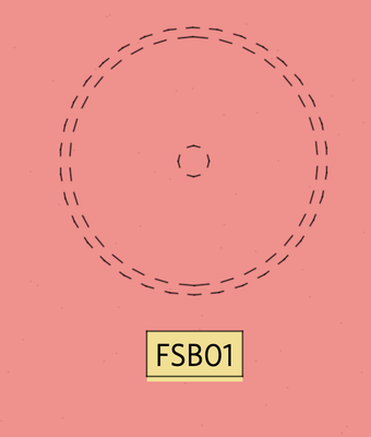

We have a selection of Properties for FF+E, with codes and descriptions in an Option Set like below :
For example, we assign the Option Set Property to a basin and use a Label to display the code.
This works great when you have something to associate to. However, without something to associate to - like if we used 2D linework instead of an Object, or have Details drawn in Worksheets - this system breaks down.

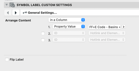

What I'm wanting to create is a Label which allows a user to select the value within an Option Set in a Property, directly in the label, without associating to an Element.
Kind of like below - instead of selecting the Property, you have the option to link to the value in the Option Set..
Is something like this possible?

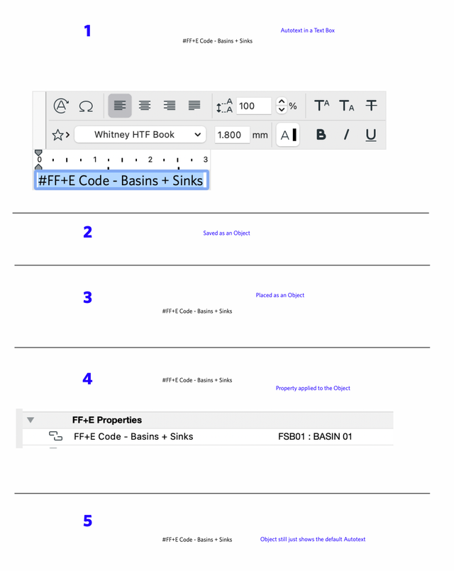

An idea - I tried saving an Object with Autotext inside which links to the FF+E property. The idea was to apply the Property to that Object, with the hopes that the Autotext inside would update. But it doesn't work like that - it's not self-referencing. Is there a way to self-reference?

2024-05-10 05:03 AM
So your object had the autotext for the property you want.
Did you then associate that object with the correct classification?

Yes, described below

2024-05-10 07:38 AM
Reading in the GDL reference, it seems only label can request properties.
So, as you have done for the basin object, it contains the property and the label can read it.
Seems you will always have to place a 'dummy' object that you can set the property in and then label that object.
