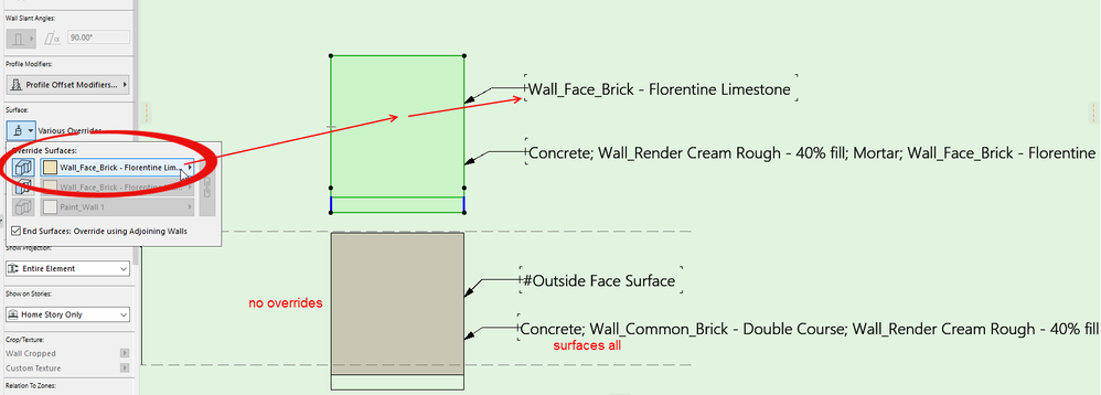

But if you use the autotext label instead of the surface label, you can get some info.
You can list 'Surfaces all' and if you override the surfaces you can list the 'inside/outside face surface' - but that will then be the same for both when you override, so defeats the purpose.
