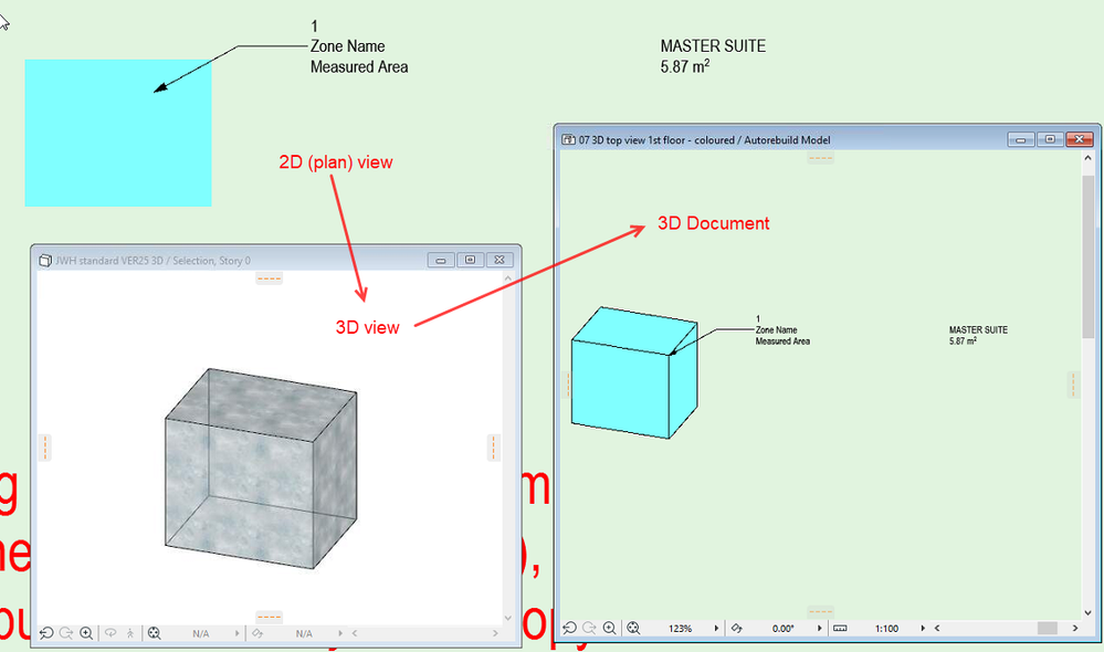

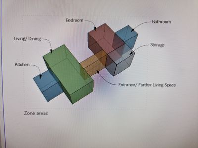

I managed to turn everything off and just show the zones. I also need to label the zones and show floor areas. I only managed to label and individual name the labels on the print page but I rather have it with labels in the 3d view and using the zone name and floor area.
Is there a better way which then would update?

If you create a 3D Document from the 3D view, you can label zones just like you do in plan.
And they will update when you change them.

I figured this out yesterday. Only problem is I want to have it opaque and not solid colours.
Unfortunately the 3D Documents can only show the material surface colour and not the render material.
And you can't document in a standard 3D view where you can see the material.
