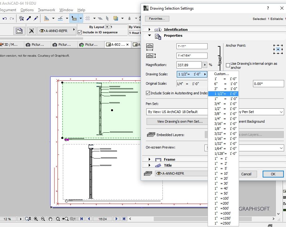

2) Wall/Detail Section:
I wasn't able to fix the scale issue (image attached). I change the scale to 1 1/2" = 1'-0" but then the drawing becomes too big and goes off the page. Then when I scale it back to a normal size it doesn't keep the scale size and reverts to a smaller scale.

2nd image for 2nd issue posted above. I am using ArchiCAD 19.
▪Wall/Detail Section:
Thanks,
Your screen shot shows that the Wall Section's original scale is 1/4"=1'-0". Drawings should be created at their output scale so text and other non-model elements size correctly. If the Wall Section is to be output at 1 1/2"=1'-0" scale, then go back to the original Wall Section, change its scale to 1 1/2"=1'-0" and adjust the text elements.
