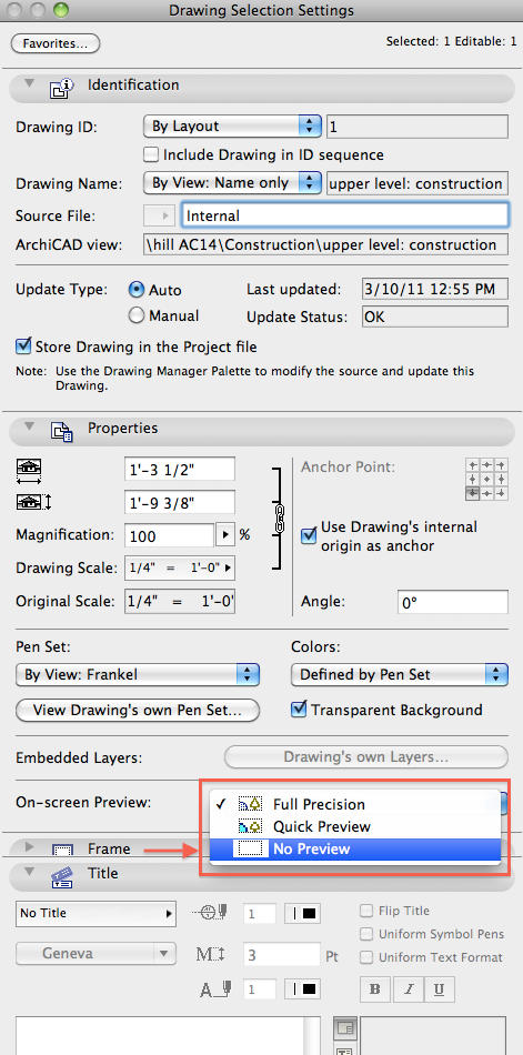

Any chance this option was selected in the Drawing Settings Pane?
Or maybe a Pen Set was chosen for those Drawings in which all colors are set to white (not very likely).
