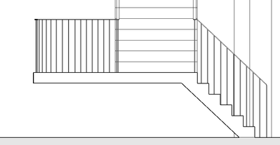

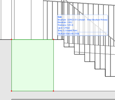

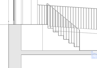

Hi there,
There is a line separating this slab and stair despite them being made of the same material.
JamesBell_0-1699522690879.pngJamesBell_1-1699522706549.pngJamesBell_2-1699522719839.png
I have a stair above that is using the same graphic overrides with no issue.
1 Reply 1
Sometimes small deviation while modeling slab causes this so get assured that the slab is quite parallel to the stair also stair may need to be rotated slightly, i hope that fixes.
