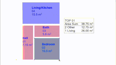

The label is automatically summing the areas of rooms in one apartment.
Check the following animation for this core functionality:

Live TOP-Stamp v0.10
Place the TOP-Stamp now directly via the Label Tool.
Choose 'Live TOP-Stamp' as the Label Type and click in your plan.
Alternatively you can also click on a room and the TOP-Stamp will use the Apartment ID of this room!
Check the video for a short demonstration:

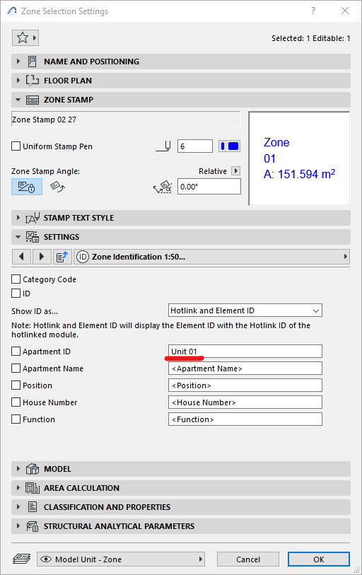

maurotrotta
Hi! Thank you for doing this, is very useful add on. Only thing is not clear to me, is the option of the label to be linked to "Apartment ID". I don´t find an Apartment ID option in the zones I have in my project, so if I want to have several apartments in one plan, the Label Add-on would collect and sum all the zones that are in the project. I guess if I can select which zones correspond to which apartment then it should work right.
Hi! You have to use "Zone Stamp 02" from the Archicad Library. It's the only stamp that supports that Apartment ID property.
Here is the corresponding option highlighted in that stamp:
Zone Labels are not compatible yet unfortunately. For other Zone Stamps there is also the option to extend them with the appropriate parameter stApartmentId in case you are familiar with GDL.
