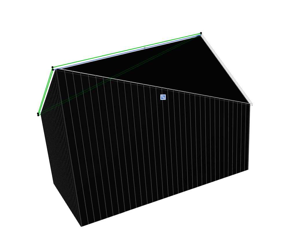

Hi All. I have had to trim vertical timber plank elements to a 'complex' multi eave line building using an 'air' roof as the trim guide for the cladding. I want to get rid of the uncut/profile lines. Any thoughts would be welcome and is this possible in ArchiCad 21?

If you are referring to the "air" roof lines the solution is to place them in a layer that will be off in all of your saved views. Usually name is X-SEO.

Many thanks Eduardo!!
