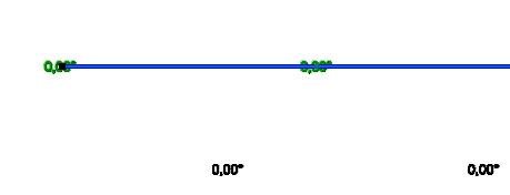

I am creating a driveway with a mesh, I am wondering if there is a way to show a grade with an automatic tool at a specific point, that will update automatically update when I change the levels at the node? i.e. the driveway wont have a single slope in a direction, it will fall in a number of directions at different angles in different places.

I am not aware of an automated solution with a mesh.
Roofs have a particular pitch where as mesh surfaces don't.
If you are handy with GDL you could make an object that allows you to set the height and position of 2 nodes and will give you the resulting grade.
But there is no way I know of to associate it to the mesh surface so it would be automatic.
I am not sure if anyone has already done this.
If someone has and they would like to share, please do.
I am not sure if it would be possible with an add-on that could detect the surface height of 2 points and give you the resulting slope.
But then you need to be able to create add-ons, or know someone that can do it for you.
I have never delved into the add-ons.

I have just tested an idea from a guardrail panel, I managed to obtain the correct value in 3D but unfortunately, the 2d projection gives me a value of zero.
!!!!SCRIPT 3D
EPS = 0,0001
ang_pan = 0
SI RAILINGPANEL_GEOMETRY[2][3]-RAILINGPANEL_GEOMETRY[1][3]> EPS OU RAILINGPANEL_GEOMETRY[2][3]-RAILINGPANEL_GEOMETRY[1][3]< -EPS ALORS
ang_pan = 90-ATN((GÉOMÉTRIE_PANNEAU_RAILING[2][1]-GÉOMÉTRIE_PANNEAU_RAILING[1][1])/ABS((GÉOMÉTRIE_PANNEAU_RAILING[2][3]-GÉOMÉTRIE_PANNEAU_RAILING[1][3])))
FIN SI
SI RAILINGPANEL_GEOMETRY[2][3]-RAILINGPANEL_GEOMETRY[1][3]> EPS ALORS ang_pan = -ang_pan
long_panneau = GÉOMÉTRIE_PANNEAU_RAILING[1][1]-GÉOMÉTRIE_PANNEAU_RAILING[2][1]
DÉFINIR LE STYLE « bb » Arial,(ht_text_3D/1000*GLOB_SCALE)*1000,5,0
STYLE DE L'ENSEMBLE "bb"
ADDX ABS(panneau_long/2)
ROTY ang_pan
TEXTE 0,01,0, STR ("%#.2dd",ABS(ang_pan))
