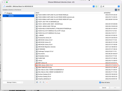

Recently, we've been facing issues with our libraries in our teamwork projects.
The Archicad 25 Library always end up missing, randomly. For example, when I open a teamwork file today everything is okay and is in place but in the next days, the whole library is missing again and what's left would be is the embedded library and another library with the project name and inside are the only library parts currently in use and existing in the model.
This happens randomly to different projects. We will reinsert the library but then again the issue will return and we have no pattern to it so it's hard to isolate the source of the problem.
We are using BIMcloud Basic. Is this related?

Please post a screenshot from "Library manager" and from "Manage BIMcloud Libraries"

Hi Filip,
Here are the screen shots.
1.  Library Manager -  as you can see, the missing objects are part of the ODG-Library-2022-V1.
2. BIMcloud Library - ODG-Library-2022-V1 is also part of he BIMcloud Library
3. Floor Plan showing the dots of the missing elements.

This Library Manager Dialog screenshot does not look good. Over 4000 warnings? There should be none, you should resolved all of them as they can cause all kinds of issues from performance issues to display and 2D/3D representation issues (e. g. when multiple versions of the same library part exist within the loaded libraries).
Also, is it the "Archicad Library 25.lcf" not located within the "Archicad Library 25" folder? Then it should not be loaded separately as it is already loaded as part of the "Archicad Library 25" folder.
Also, why are PLA files loaded as libraries? That is a bad practice. What kind of library parts are located in those PLA files that are not available in the other libraries? If there are project-specific library parts, those should be in the Embedded Library, not loaded from a PLA.
Also, is it necessary to load both the 22 and 25 version of the Surface Catalog?
Someone should really clean up these library issues at your office, preferably someone with BIM Manager knowledge.
