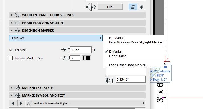

Missing door marker library missing
My door marker options seem to be limited. Does anyone know the protocol to install Door Marker 27? or similar
Setup info provided by author
6 Replies 6
You are on 29 and if you have the Global Libraries loaded, there is no object called 'Door Marker 27', it will just be 'Door Marker'.
But this may depend on the library packs that you have loaded.
What libraries do you have loaded?
You can also use the "Load Other Door Marker" command on the list of markers. You will then be able to select a Door library part from a location on your computer, which will then be loaded into the Embedded Library of your project and be ready for use.
FWRD_151
Thanks Barry, I only have 29 installed out of the box. I'm trying to have the ability to move my door marker in the x and y direction. Right now i can only move it in one direction on the floor plan. I was told door marker 27 can do what I'm looking for. I'm assuming there is a library pack i can download with more marker options. I'll do some digging and follow up.
FWRD_151
Laszlo, Thanks. I'm searching GS site now to find some door markers to load in
Lingwisyer
Guru
Have you loaded the "Annotation Elements.libpack"?
FWRD_151
quick update- it appears 29 does not have a door marker option that lets you move the marker in both X and Y axis. My solution is to label my door /window sizes with linked labels.
