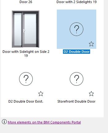

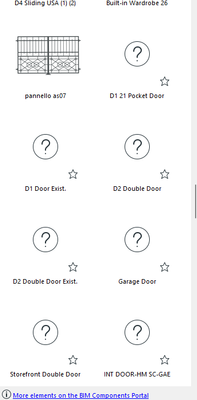

What is the best way to recover the missing doors?

From your first screenshot you are missing a AC19 Door, loading Migration Libraries should have fix it. The other screenshot indicates that you are missing AC26 objects and loading the AC26 Library should fix it.
