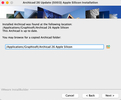

Good afternoon,
Thank you for the info. I've tried to follow the "Repair" process but when I go to the install window, there is no option for "Repair". Could another way to get to the "repair" window/option exist?
That is update 5003 you are installing - that will only update and not repair.
You must re-install the original Archicad first (build 3000) - this will prompt you to repair.
Then install the goodies and then updated 5003.
Thank you very much! This worked. Thanks again for your help, I really appreciate it!
