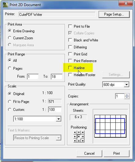

I have done some searching but couldn't find anything to help me. I would like for some of the materials on my elevations to be somewhat lighter. I PDF most of my drawings, and the materials sometimes come out too dark. Example, If i use a brick face on my composite wall, in elevation the brick jumps out. In certain situations I would like the brick to be almost invisible in elevation. I have looked at materials and pens and just am not seeing anything. I'm sure its something simple and Im just not seeing the forrest for the trees. In the example, the stonework is too dark. I would like it to be lighter. What am I missing here?

Thanks for the reply. I do use different pen/lineweights for different items. But for some reason when I PDF them, there is no difference that i can see in them. These two walls in the picture are different lineweights, but no discernable diff that I can see. What gives here? Any ideas anyone?
If you Publish your PDF through the Publisher then check the Document Settings.
If you print directly from Archicad as a PDF then you will have a similar option.
I always publish this way and the hairline box is never checked. There has to be something that I am missing. Is there not some other way to make it more transparent other than pen settings?
