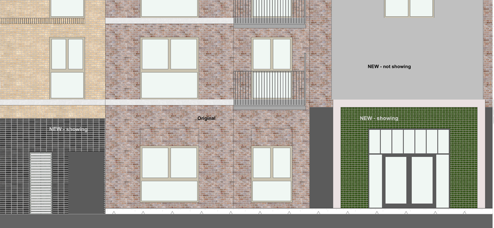

I have just created a couple of new textures which are showing nicely in 3D, however, they are not showing up in elevations. Uncut Fill is set to Surface - Texture Fill, Non-Shaded, fade distant elements is off. The surface settings were copied from a similar texture which shows.
Other new textures are showing up. Any ideas, what else I could do?

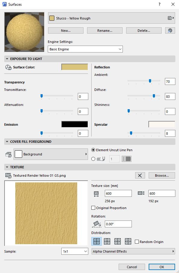

What are your settings for the surface for that element? Can you send a picture of that? - Like what I have attached

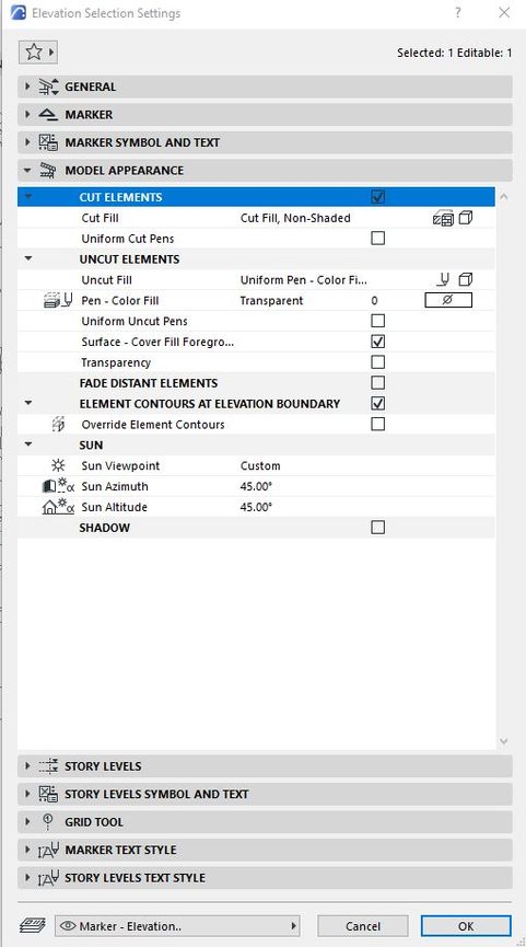

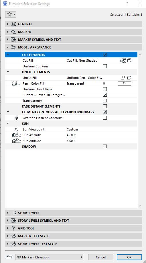

Also, can you send an image of the elevation settings you have, under the model appearance tab? - Like what I have attached
Is the issue you are having in every elevation view, or just 1 or 2?
