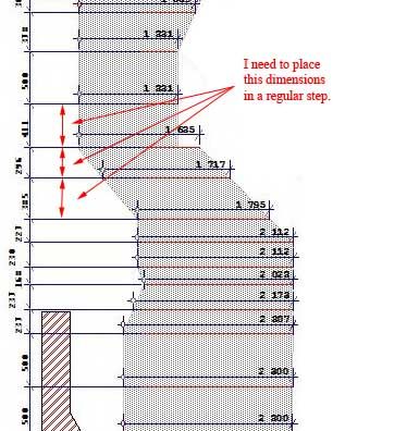

I'm a newbie, please help me with archicad. I have an irregular-shaped area. I need to place dimensions with a regular given step. I.e. i want to place horizontal dimensions on a regular vertical "grid"... I hope I asking well. Please ask additional questions if something is not clear..

You could place hotspots using the multiply command at your regular step locations and dimension to them.

Or, you could use the structural grid tool, with the option to automatically insert dimensions...

Could you, please, write me step-by-step instructions? How to achieve this?
I attached a file with screenshot what I need...

-place a hotspot on the lower point.
-Select the hotspot
-Edit ->Multiply->Drag/spread/spacing(define the distance)/OK
-click on the plan->move vertically and press shift->the hotspots are copied
-use them as reference points for the dimension tool (click on them) as Gerald suggested.

On using Multiply, see my attached PDF (from one of my seminars)
