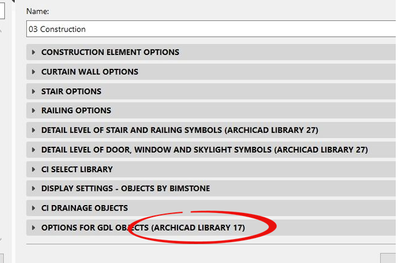

It is a Model View Option setting - same as before I believe?

2024-04-08 03:06 AM
Thats what I thought it might have been but seems as though I don't even have that option any more...
Only change that was done to the setup of the file was the update to 27.2.0.

2024-04-08 04:02 AM
Looks like you had an addition version 17 library loaded?

2024-04-08 04:29 AM
cleaned up...
