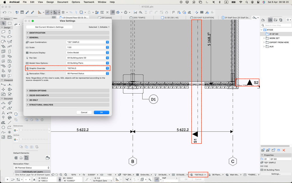

1. How the Source View looks.
2. The View Settings.
3. How it looks on the Layouts.
4. The Drawing Settings of View placed on the Layout.

Hi Laszlo, thanks for jumping in. Please see below screenshots of both the View source and the Layout screen, with their respective settings.
I have amended the thread title to reflect that it's only the Section Markers that show in the wrong Pen, not the lines themselves. My apologies.

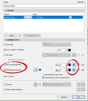

Can you show a screen shot of your Graphic Override rule settings?
Maybe you are not overriding the foreground and background pen colours for the fill (drafting fills)?

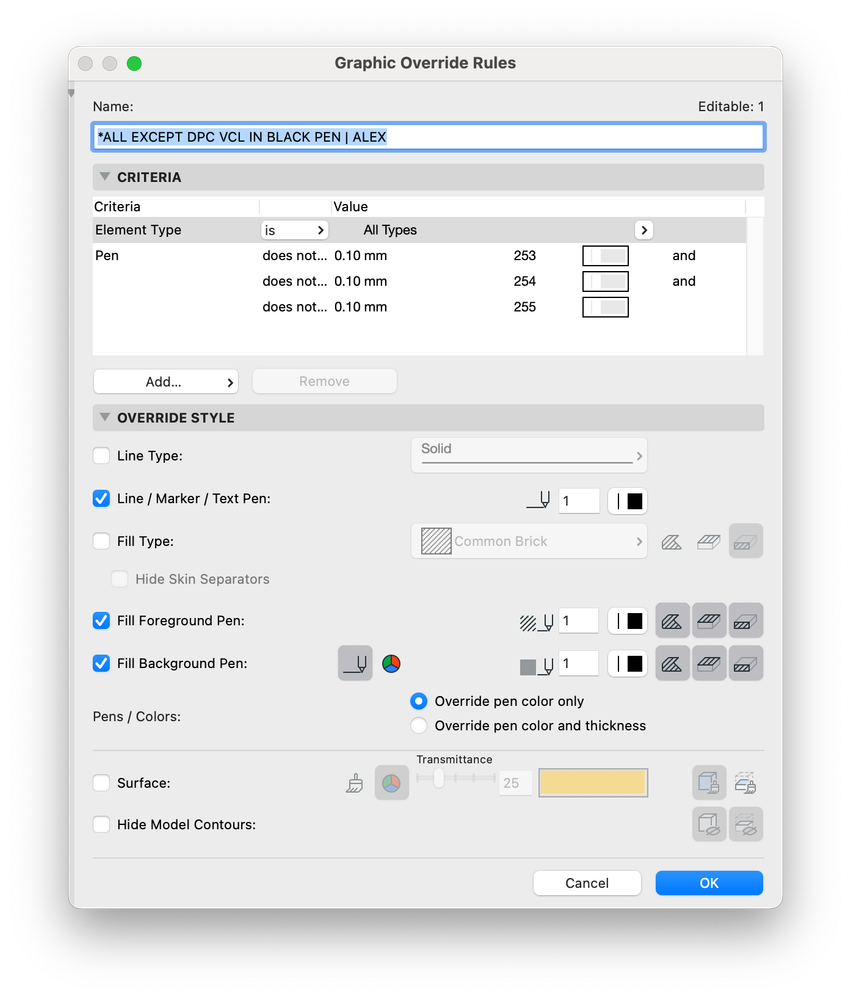

Hi Barry, thanks for your reply. My GO is using a single rule, which turns everything except my DPC and VCL to black:

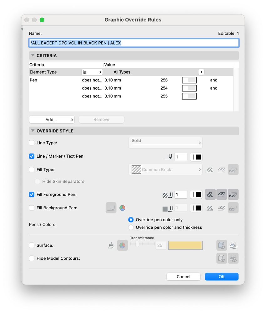

If I switch the background colour as well, like this:
that results in something different to what I want in Plan view:
My rule, as already configured, works correctly for my needs. But it simply 'misses' the Section Markers in Layout only (works fine in Plan view).
