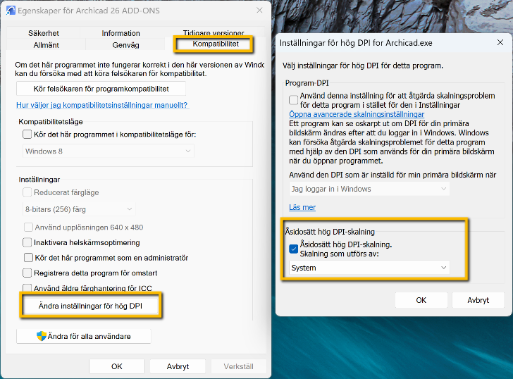

Had this question at the office and solved it by right-clicking on the AC-desktop icon, going to properties and changing the DPI-scale to "System". See attached screeenshot.
Vasileios S_
Thanks @Gortz !
